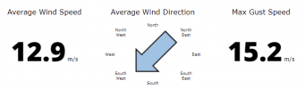

The explanation is that you flew in much stronger winds than what you think ... flew out 2,65 kilometres over the sea with the wind until you had 38% battery left... initiated RTH with a set height of 175m which placed you MA2s in even stronger winds & depleted the battery further both during the ascend & way back. You luckily reached the shore & was only 46m from your HP when you cancelled the RTH ... right there the battery was on 18%. Surprisingly you then steered the MA2s out over the sea again ... And 386m from the HP with a direct headwind back with only 11% battery left ... the lowbattery autolanding started.
You should have aborted the flight when the craft returned from the RTH phase ... you sealed the disaster when you continued to fly.
The reason for this incident was plain & simple ignorance ... both regarding craft functions, how wind usually behaves on higher altitudes & how to manage LiPo batteries.
Here below all relevant... & sad data from the log.
(Click on the chart to make it larger)
And here the winds your craft faced up there ...

If you look at the 'artificial horizon" at around 11:36, it is almost central and horizontal meaning the drone was very nearly in the hover position, yet you are commanding maximum forward speed and the drone is moving at around 33mph.
How is that possible? As I understand it the answer is, it is in a strong tail wind, 54kph, and flying downwind, it doesn't need to tilt to move in the desired direction.
In the end you simply drained the battery so much that the then headwind and distance were too much for it to make it home on what power it had left
