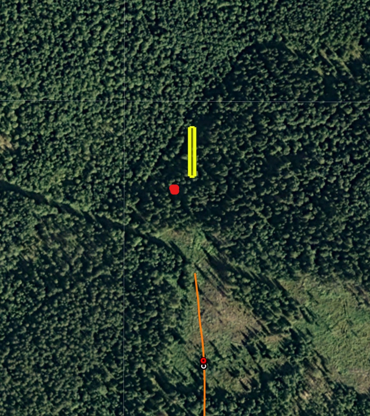

When it reached the critical low battery level at 570.5 seconds it initiated autoland and began to descend. The ground elevation at that location was around 10 m lower than the takeoff point, so extrapolating altitude downwards, and assuming that it will have landed on the ground (- 10 m) or hit a tree (estimating + 10 m) we can estimated how far further from the last recorded point it might have travelled.
That gives between 75 m and 115 m north, and between 8 m and 12 m west. On Google Earth, that is shown by the yellow box below:

I FOUND THE BIRD! :) I found it on the ground, and it was fine, except for some moisture inside it due to some rain during those 16 days it was waiting for me.
Thank you all for your inputs, and especially to sar104 for that profound explanation of the possible landing point! You deserve a gold star!
The red dot in the picture is the place where i found it, so sar104 was very close with the yellow lines:
Thanks for the follow up information and I'm glad that you found it. In hindsight I'm not surprised by the location. Firstly, we should expect the wind speed to drop nearer the ground, meaning less drift. Secondly, the drift was swinging slightly more westerly right at the end as you can see on the aerial image and the velocity graph. In this case a linear extrapolation wasn't the best strategy - I'll pay more attention to that next time. I thought after I posted that the flight path wasn't quite pointing at the predicted location, but I figured that you would check out that area anyway.
